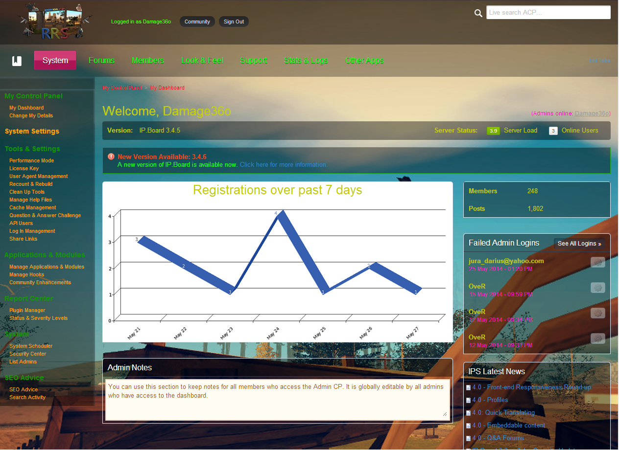

Bogdan Trif Posted May 25, 2014 Report Posted May 25, 2014 Cum scot graficul cu registration over past 7 days si Admin notes din ACP IPB?

Bogdan Trif Posted May 25, 2014 Author Report Posted May 25, 2014 e prima oara cand folosesti ipb? daaa de acum un an ii prima oara doamnee............. nu gasesc alea nicaieri sa le pot scoate omule )) uite forum facut de mine : www.rrs-ro.net/forum + acp-u modificat : http://imgur.com/a/hYxqs

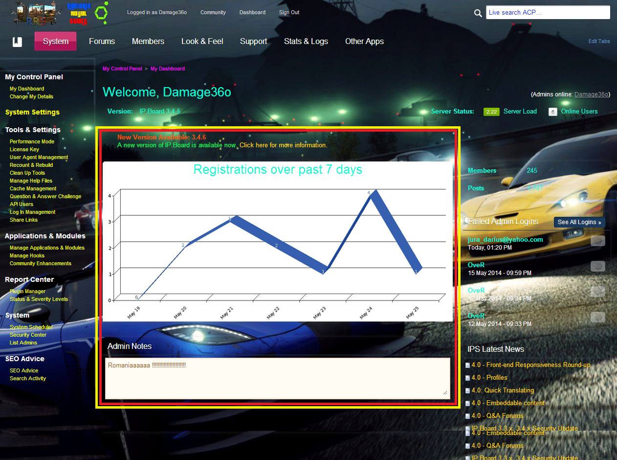

Moderators Courage Posted May 25, 2014 Moderators Report Posted May 25, 2014 Cam varza pe acolo.Uite ce mi-a iesit mie: http://i.imgur.com/wl9qcLe.png
Bogdan Trif Posted May 25, 2014 Author Report Posted May 25, 2014 Cam varza pe acolo. Uite ce mi-a iesit mie: http://i.imgur.com/wl9qcLe.png eu incerc mai multe ... in fine ... unde gasesc aia ?
Moderators Courage Posted May 25, 2014 Moderators Report Posted May 25, 2014 Cauta-le prin fisiere cu Notepad++
Bogdan Trif Posted May 27, 2014 Author Report Posted May 27, 2014 Cauta-le prin fisiere cu Notepad++ uite ... dar ca nu gasesc aia
Solution +th3#afk Posted May 30, 2014 Solution Report Posted May 30, 2014 admin/applications/core/skin_cp/cp_skin_mycp.php cauta : $IPBHTML .= <<<EOF <div class='acp-box' style='background: #FFF'> <div class='center section_title'><h2>{$_lang}</h2></div> <div class='center' id='dashboard_graph' style='padding: 1px;'><img src="{$this->settings['base_url']}module=system&section=charts&days=7" alt="{$this->lang->words['reg_trends_chart']}" style='width:98%;' /></div> </div> <br /><br />EOF; La mine apare in linia nr 172 save and thanks . 2 Mi-e teama de ziua in care tehnologia va fi mai importanta ca relatiile interumane.In lume va exista o generatie de idioti !! - Albert Einstein www.gamelife.ro
