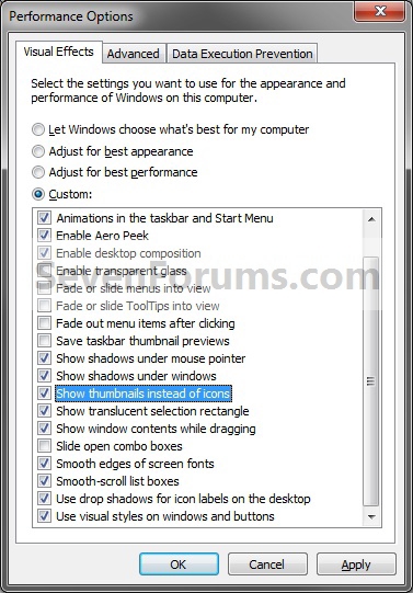

Incearca asta:
Click dreapta pe My computer -> Proprieties -> Advanced Settings -> Advanced -> Performance -> Settings -> Cauta Show thumbnails instead of icons si bifeaza-i casuta.
Sau foloseste un registru:
http://www.upload.ee/files/2722783/Enable_Explorer_Thumbnails_All_Users.reg.html
Sau manual, prin Group Policy:
User Configuration-> Administrative Template-> Windows Comp-> Windows Explorer-> Turn off the display of thumbnails and only display icons-> Edit si seteaza-l pe Disabled sau Not configured.
