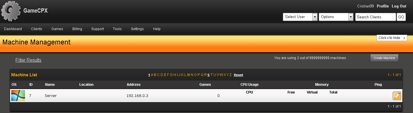

Apeiron Cristy Posted August 28, 2014 Report Posted August 28, 2014 La Machine Management trebuie sa bag IP-ul meu, sau care ca nu inteleg? Cand dau sa mi se faca jocul primesc: Unable to automatically determine IP address. Please check machine or game configuration.

Solution Sebastian C. Posted September 1, 2014 Solution Report Posted September 1, 2014 El nu avea un dedicat/vps/vds pentru a putea hosta servere , pe webhost nu poti face un server . 1
